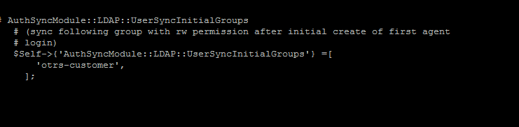

HI, See the attached above. Check this, may you find something can fix your issue. From: otrs-bounces@otrs.org [mailto:otrs-bounces@otrs.org] On Behalf Of Erik van Ast Sent: Wednesday, May 28, 2014 12:07 PM To: User questions and discussions about OTRS. Subject: Re: [otrs] Authentication succeeded, but no customer record is found in the customer backend. Please contact your administrator. Hi Yousef, Thank you for your reply. We already have a group (Global Security group) and the users are a member of that group. Authentication is not the problem as you can see in the error, the problem is synchronizing the account from AD with LDAP into the OTRS database Met vriendelijke groet / Kind regards / Mit freundlichem Gruß, Erik From: otrs-bounces@otrs.org [mailto:otrs-bounces@otrs.org] On Behalf Of Yousef Hamad Sent: woensdag 28 mei 2014 10:35 To: 'User questions and discussions about OTRS.' Subject: Re: [otrs] Authentication succeeded, but no customer record is found in the customer backend. Please contact your administrator. Yes of course, That because you should create two groups on Domain Controller and then add the created user on a domain to the group, So customers will authenticate and find its account record there. Regards, Yousef Hamad |Technical Support Engineer ASPIRE | 120 & 130 Queen Rania St | Amman | Jordan (M) +962 799372852 From: otrs-bounces@otrs.org [mailto:otrs-bounces@otrs.org] On Behalf Of Erik van Ast Sent: Wednesday, May 28, 2014 11:00 AM To: otrs@otrs.org Subject: Re: [otrs] Authentication succeeded, but no customer record is found in the customer backend. Please contact your administrator. Hi all, Does anyone have an idea about this? Is it because of the CustomerID? Met vriendelijke groet / Kind regards / Mit freundlichem Gruß, Erik From: Erik van Ast Sent: maandag 26 mei 2014 16:40 To: 'otrs@otrs.org' Subject: Authentication succeeded, but no customer record is found in the customer backend. Please contact your administrator. Hi all, When trying to log in as a customer, I get the error Authentication succeeded, but no customer record is found in the customer backend. Please contact your administrator.. Authentication works good, but apparently the information from Active Directory does not synchronize to OTRS When I use a wrong password I get the error Login failed! Your user name or password was entered incorrectly, so authenticating works good As soon as I get the error mentioned earlier, I see the following error in the otrs.log [Error][Kernel::System::CustomerUser::SetPreferences][587] No such user 'HaraldW'. Agents have no problem logging in, so I think I wont have to think about that part, but the customer authentication part of my config.pm looks like this (I have replaced parts with xxx for security reasons) : # This is an example configuration for an LDAP auth. backend. # (make sure Net::LDAP is installed!) $Self->{'Customer::AuthModule3'} = 'Kernel::System::CustomerAuth::LDAP'; $Self->{'Customer::AuthModule::LDAP::Host3'} = 'xxx.xxx.xxx.xxx'; $Self->{'Customer::AuthModule::LDAP::BaseDN3'} = 'dc=xxx,dc=xxx'; $Self->{'Customer::AuthModule::LDAP::UID3'} = 'sAMAccountName'; # Check if the user is allowed to auth in a posixGroup # (e. g. user needs to be in a group xyz to use otrs) $Self->{'Customer::AuthModule::LDAP::GroupDN3'} = 'CN=OTRS_Users,OU=XXX,DC=xxx,DC=xxx'; $Self->{'Customer::AuthModule::LDAP::AccessAttr3'} = 'member'; # for ldap posixGroups objectclass (just uid) # $Self->{'Customer::AuthModule::LDAP::UserAttr'} = 'UID'; # for non ldap posixGroups objectclass (full user dn) $Self->{'Customer::AuthModule::LDAP::UserAttr3'} = 'DN'; # The following is valid but would only be necessary if the # anonymous user does NOT have permission to read from the LDAP tree $Self->{'Customer::AuthModule::LDAP::SearchUserDN3'} = 'CN=XXXXXX,OU=IT Department,OU=XXX,DC=xxx,DC=xxx'; $Self->{'Customer::AuthModule::LDAP::SearchUserPw3'} = 'XXXXXXX'; # in case you want to add always one filter to each ldap query, use # this option. e. g. AlwaysFilter => '(mail=*)' or AlwaysFilter => '(objectclass=user)' # $Self->{'Customer::AuthModule::LDAP::AlwaysFilter'} = ''; # in case you want to add a suffix to each customer login name, then # you can use this option. e. g. user just want to use user but # in your ldap directory exists user@domain. #$Self->{'Customer::AuthModule::LDAP::UserSuffix'} = '@domain.com'; # Net::LDAP new params (if needed - for more info see perldoc Net::LDAP) $Self->{'Customer::AuthModule::LDAP::Params3'} = { port => 389, timeout => 120, async => 0, version => 3, }; # LATER TOEGEVOEGD, SYNC: # Example 4.8. Configuring an LDAP customer backend # CustomerUser # (customer ldap backend and settings) $Self->{CustomerUser2} = { Name => 'LDAP Data Source', Module => 'Kernel::System::CustomerUser::LDAP', Params => { # ldap host Host => 'xxx.xxx.xxx.xxx', # ldap base dn BaseDN => 'dc=xxx,dc=xxx', # search scope (one|sub) SSCOPE => 'sub', # The following is valid but would only be necessary if the # anonymous user does NOT have permission to read from the LDAP tree UserDN => 'CN=XXXXXX,OU=IT Department,OU=XXX,DC=xxx,DC=xxx', UserPw => 'XXXXXXX', # in case you want to add always one filter to each ldap query, use # this option. e. g. AlwaysFilter => '(mail=*)' or AlwaysFilter => '(objectclass=user)' AlwaysFilter => '(memberOf='CN=OTRS_Users,OU=XXX,DC=xxx,DC=xxx)', # if both your frontend and your LDAP are unicode, use this: # SourceCharset => 'utf-8', # DestCharset => 'utf-8', # if your frontend is unicode and the charset of your # ldap server is iso-8859-1, use these options. # SourceCharset => 'iso-8859-1', # DestCharset => 'utf-8', # Net::LDAP new params (if needed - for more info see perldoc Net::LDAP) Params => { port => 389, timeout => 120, async => 0, version => 3, }, }, # customer unique id CustomerKey => 'sAMAccountName', # customer # CustomerID => 'company', CustomerUserListFields => ['sAMAccountName', 'cn', 'mail'], CustomerUserSearchFields => ['sAMAccountName', 'cn', 'mail'], CustomerUserSearchPrefix => '', CustomerUserSearchSuffix => '*', CustomerUserSearchListLimit => 250, CustomerUserPostMasterSearchFields => ['mail'], CustomerUserNameFields => ['givenname', 'sn'], # show not own tickets in customer panel, CompanyTickets # CustomerUserExcludePrimaryCustomerID => 0, # add an ldap filter for valid users (expert setting) # CustomerUserValidFilter => '(!(description=locked))', # administrator can't change customer preferences # AdminSetPreferences => 0, # # cache time to live in sec. - cache any database queries # CacheTTL => 0, Map => [ # note: Login, Email and CustomerID are mandatory! # var, frontend, storage, shown (1=always,2=lite), required, storage-type, http-link, readonly [ 'UserTitle', 'Title', 'title', 1, 0, 'var', '', 0 ], [ 'UserFirstname', 'Firstname', 'givenname', 1, 1, 'var', '', 0 ], [ 'UserLastname', 'Lastname', 'sn', 1, 1, 'var', '', 0 ], [ 'UserLogin', 'Username', 'sAMAccountName', 1, 1, 'var', '', 0 ], [ 'UserEmail', 'Email', 'mail', 1, 1, 'var', '', 0 ], [ 'UserCustomerID', 'CustomerID', 'company', 0, 1, 'var', '', 0 ], # [ 'UserCustomerIDs', 'CustomerIDs', 'second_customer_ids', 1, 0, 'var', '', 0 ], [ 'UserPhone', 'Phone', 'telephonenumber', 1, 0, 'var', '', 0 ], [ 'UserAddress', 'Address', 'postaladdress', 1, 0, 'var', '', 0 ], [ 'UserComment', 'Comment', 'description', 1, 0, 'var', '', 0 ], ], }; Can someone please help me with this? Ive been searching on the web for quite some time now, and I cant figure it out All our users have the same company name so everyone can see each others tickets, thats why we use company as CustomerID instead of sAMAccountName OTRS is installed on a Windows 2012 server, the database is SQL 2008 Express and the OTRS version we use is 3.3.7 Kind regards, Erik ______________________________________________________________________ This email has been scanned by the IT101 Email Security System. For more information please visit http://www.it101.be ______________________________________________________________________
You pointed me in the right direction. The error was in the "AlwaysFilter" part... If I disable that, all users in our AD are imported into OTRS and only the ones member of the group can log in, but that is not what I want... I want only the users member of a particular group to be synchronized in OTRS, but how can I do that? This part doesn't seem to work: $Self->{CustomerUser} = { Name => 'LDAP Backend', Module => 'Kernel::System::CustomerUser::LDAP', Params => { Host => 'XXX.XXX.XXX.XXX', BaseDN => 'dc=XXX=XXX', SSCOPE => 'sub', UserDN => 'CN=XXX,OU=XXX=XXX,DC=XXX', UserPw => 'xxxxxxx', AlwaysFilter => '(objectclass=user)(memberOf=CN=OTRS_Users,OU=XXX,DC=XXXX,DC=XXX)', }, CustomerKey => 'sAMAccountName', CustomerID => 'company', CustomerUserListFields => ['sAMAccountName', 'cn', 'mail'], CustomerUserSearchFields => ['sAMAccountName', 'cn', 'mail'], CustomerUserSearchListLimit => 1000, CustomerUserPostMasterSearchFields => ['mail'], CustomerUserNameFields => ['givenname', 'sn'], Map => [ [ 'UserFirstname', 'Firstname', 'givenname', 1, 1, 'var' ], [ 'UserLastname', 'Lastname', 'sn', 1, 1, 'var' ], [ 'UserLogin', 'Login', 'sAMAccountName', 1, 1, 'var' ], [ 'UserEmail', 'Email', 'mail', 1, 1, 'var' ], [ 'UserCustomerID', 'CustomerID', 'company', 0, 1, 'var' ], Is my "AlwaysFilter" part wrong? Or in the wrong location? Met vriendelijke groet / Kind regards / Mit freundlichem Gruß, Erik From: otrs-bounces@otrs.org [mailto:otrs-bounces@otrs.org] On Behalf Of Yousef Hamad Sent: woensdag 28 mei 2014 12:08 To: 'User questions and discussions about OTRS.' Subject: Re: [otrs] Authentication succeeded, but no customer record is found in the customer backend. Please contact your administrator. HI, See the attached above. Check this, may you find something can fix your issue. From: otrs-bounces@otrs.orgmailto:otrs-bounces@otrs.org [mailto:otrs-bounces@otrs.org] On Behalf Of Erik van Ast Sent: Wednesday, May 28, 2014 12:07 PM To: User questions and discussions about OTRS. Subject: Re: [otrs] Authentication succeeded, but no customer record is found in the customer backend. Please contact your administrator. Hi Yousef, Thank you for your reply. We already have a group (Global Security group) and the users are a member of that group. Authentication is not the problem as you can see in the error, the problem is synchronizing the account from AD with LDAP into the OTRS database... Met vriendelijke groet / Kind regards / Mit freundlichem Gruß, Erik From: otrs-bounces@otrs.orgmailto:otrs-bounces@otrs.org [mailto:otrs-bounces@otrs.org] On Behalf Of Yousef Hamad Sent: woensdag 28 mei 2014 10:35 To: 'User questions and discussions about OTRS.' Subject: Re: [otrs] Authentication succeeded, but no customer record is found in the customer backend. Please contact your administrator. Yes of course, That because you should create two groups on Domain Controller and then add the created user on a domain to the group, So customers will authenticate and find its account record there. Regards, Yousef Hamad |Technical Support Engineer [cid:image001.png@01CF7A92.A8EAAE80] ASPIRE | 120 & 130 Queen Rania St | Amman | Jordan (M) +962 799372852 From: otrs-bounces@otrs.orgmailto:otrs-bounces@otrs.org [mailto:otrs-bounces@otrs.org] On Behalf Of Erik van Ast Sent: Wednesday, May 28, 2014 11:00 AM To: otrs@otrs.orgmailto:otrs@otrs.org Subject: Re: [otrs] Authentication succeeded, but no customer record is found in the customer backend. Please contact your administrator. Hi all, Does anyone have an idea about this? Is it because of the CustomerID? Met vriendelijke groet / Kind regards / Mit freundlichem Gruß, Erik From: Erik van Ast Sent: maandag 26 mei 2014 16:40 To: 'otrs@otrs.org' Subject: Authentication succeeded, but no customer record is found in the customer backend. Please contact your administrator. Hi all, When trying to log in as a customer, I get the error "Authentication succeeded, but no customer record is found in the customer backend. Please contact your administrator.". Authentication works good, but apparently the information from Active Directory does not synchronize to OTRS... When I use a wrong password I get the error "Login failed! Your user name or password was entered incorrectly", so authenticating works good... As soon as I get the error mentioned earlier, I see the following error in the otrs.log "[Error][Kernel::System::CustomerUser::SetPreferences][587] No such user 'HaraldW'. Agents have no problem logging in, so I think I won't have to think about that part, but the customer authentication part of my config.pm looks like this (I have replaced parts with xxx for security reasons) : # This is an example configuration for an LDAP auth. backend. # (make sure Net::LDAP is installed!) $Self->{'Customer::AuthModule3'} = 'Kernel::System::CustomerAuth::LDAP'; $Self->{'Customer::AuthModule::LDAP::Host3'} = 'xxx.xxx.xxx.xxx'; $Self->{'Customer::AuthModule::LDAP::BaseDN3'} = 'dc=xxx,dc=xxx'; $Self->{'Customer::AuthModule::LDAP::UID3'} = 'sAMAccountName'; # Check if the user is allowed to auth in a posixGroup # (e. g. user needs to be in a group xyz to use otrs) $Self->{'Customer::AuthModule::LDAP::GroupDN3'} = 'CN=OTRS_Users,OU=XXX,DC=xxx,DC=xxx'; $Self->{'Customer::AuthModule::LDAP::AccessAttr3'} = 'member'; # for ldap posixGroups objectclass (just uid) # $Self->{'Customer::AuthModule::LDAP::UserAttr'} = 'UID'; # for non ldap posixGroups objectclass (full user dn) $Self->{'Customer::AuthModule::LDAP::UserAttr3'} = 'DN'; # The following is valid but would only be necessary if the # anonymous user does NOT have permission to read from the LDAP tree $Self->{'Customer::AuthModule::LDAP::SearchUserDN3'} = 'CN=XXXXXX,OU=IT Department,OU=XXX,DC=xxx,DC=xxx'; $Self->{'Customer::AuthModule::LDAP::SearchUserPw3'} = 'XXXXXXX'; # in case you want to add always one filter to each ldap query, use # this option. e. g. AlwaysFilter => '(mail=*)' or AlwaysFilter => '(objectclass=user)' # $Self->{'Customer::AuthModule::LDAP::AlwaysFilter'} = ''; # in case you want to add a suffix to each customer login name, then # you can use this option. e. g. user just want to use user but # in your ldap directory exists user@domain. #$Self->{'Customer::AuthModule::LDAP::UserSuffix'} = '@domain.com'; # Net::LDAP new params (if needed - for more info see perldoc Net::LDAP) $Self->{'Customer::AuthModule::LDAP::Params3'} = { port => 389, timeout => 120, async => 0, version => 3, }; # LATER TOEGEVOEGD, SYNC: # Example 4.8. Configuring an LDAP customer backend # CustomerUser # (customer ldap backend and settings) $Self->{CustomerUser2} = { Name => 'LDAP Data Source', Module => 'Kernel::System::CustomerUser::LDAP', Params => { # ldap host Host => 'xxx.xxx.xxx.xxx', # ldap base dn BaseDN => 'dc=xxx,dc=xxx', # search scope (one|sub) SSCOPE => 'sub', # The following is valid but would only be necessary if the # anonymous user does NOT have permission to read from the LDAP tree UserDN => 'CN=XXXXXX,OU=IT Department,OU=XXX,DC=xxx,DC=xxx', UserPw => 'XXXXXXX', # in case you want to add always one filter to each ldap query, use # this option. e. g. AlwaysFilter => '(mail=*)' or AlwaysFilter => '(objectclass=user)' AlwaysFilter => '(memberOf='CN=OTRS_Users,OU=XXX,DC=xxx,DC=xxx)', # if both your frontend and your LDAP are unicode, use this: # SourceCharset => 'utf-8', # DestCharset => 'utf-8', # if your frontend is unicode and the charset of your # ldap server is iso-8859-1, use these options. # SourceCharset => 'iso-8859-1', # DestCharset => 'utf-8', # Net::LDAP new params (if needed - for more info see perldoc Net::LDAP) Params => { port => 389, timeout => 120, async => 0, version => 3, }, }, # customer unique id CustomerKey => 'sAMAccountName', # customer # CustomerID => 'company', CustomerUserListFields => ['sAMAccountName', 'cn', 'mail'], CustomerUserSearchFields => ['sAMAccountName', 'cn', 'mail'], CustomerUserSearchPrefix => '', CustomerUserSearchSuffix => '*', CustomerUserSearchListLimit => 250, CustomerUserPostMasterSearchFields => ['mail'], CustomerUserNameFields => ['givenname', 'sn'], # show not own tickets in customer panel, CompanyTickets # CustomerUserExcludePrimaryCustomerID => 0, # add an ldap filter for valid users (expert setting) # CustomerUserValidFilter => '(!(description=locked))', # administrator can't change customer preferences # AdminSetPreferences => 0, # # cache time to live in sec. - cache any database queries # CacheTTL => 0, Map => [ # note: Login, Email and CustomerID are mandatory! # var, frontend, storage, shown (1=always,2=lite), required, storage-type, http-link, readonly [ 'UserTitle', 'Title', 'title', 1, 0, 'var', '', 0 ], [ 'UserFirstname', 'Firstname', 'givenname', 1, 1, 'var', '', 0 ], [ 'UserLastname', 'Lastname', 'sn', 1, 1, 'var', '', 0 ], [ 'UserLogin', 'Username', 'sAMAccountName', 1, 1, 'var', '', 0 ], [ 'UserEmail', 'Email', 'mail', 1, 1, 'var', '', 0 ], [ 'UserCustomerID', 'CustomerID', 'company', 0, 1, 'var', '', 0 ], # [ 'UserCustomerIDs', 'CustomerIDs', 'second_customer_ids', 1, 0, 'var', '', 0 ], [ 'UserPhone', 'Phone', 'telephonenumber', 1, 0, 'var', '', 0 ], [ 'UserAddress', 'Address', 'postaladdress', 1, 0, 'var', '', 0 ], [ 'UserComment', 'Comment', 'description', 1, 0, 'var', '', 0 ], ], }; Can someone please help me with this? I've been searching on the web for quite some time now, and I can't figure it out... All our users have the same company name so everyone can see each other's tickets, that's why we use "company" as CustomerID instead of sAMAccountName... OTRS is installed on a Windows 2012 server, the database is SQL 2008 Express and the OTRS version we use is 3.3.7 Kind regards, Erik ______________________________________________________________________ This email has been scanned by the IT101 Email Security System. For more information please visit http://www.it101.be ______________________________________________________________________ ______________________________________________________________________ This email has been scanned by the IT101 Email Security System. For more information please visit http://www.it101.be ______________________________________________________________________
